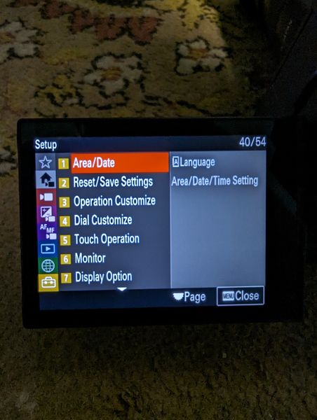

i’ve upgraded my A7iv from version 2.00 to 3.01 and lost the pal ntsc selector.
any fixes?

i got it from outside the eu zone. does that make any difference?
if yes, how can i fix it?

Sorry, I hadn’t seen your flag. It’s clear that you brought out of EU. :slight_smile:
Yes, maybe that it can affect the options you can select. Actually I don’t know why Sony made that.
Anyway, check your menu as in my picture with selector on “video mode”.
Otherwise you can try to initialise camera settings in case the double jump of fw update had broken something on settings
