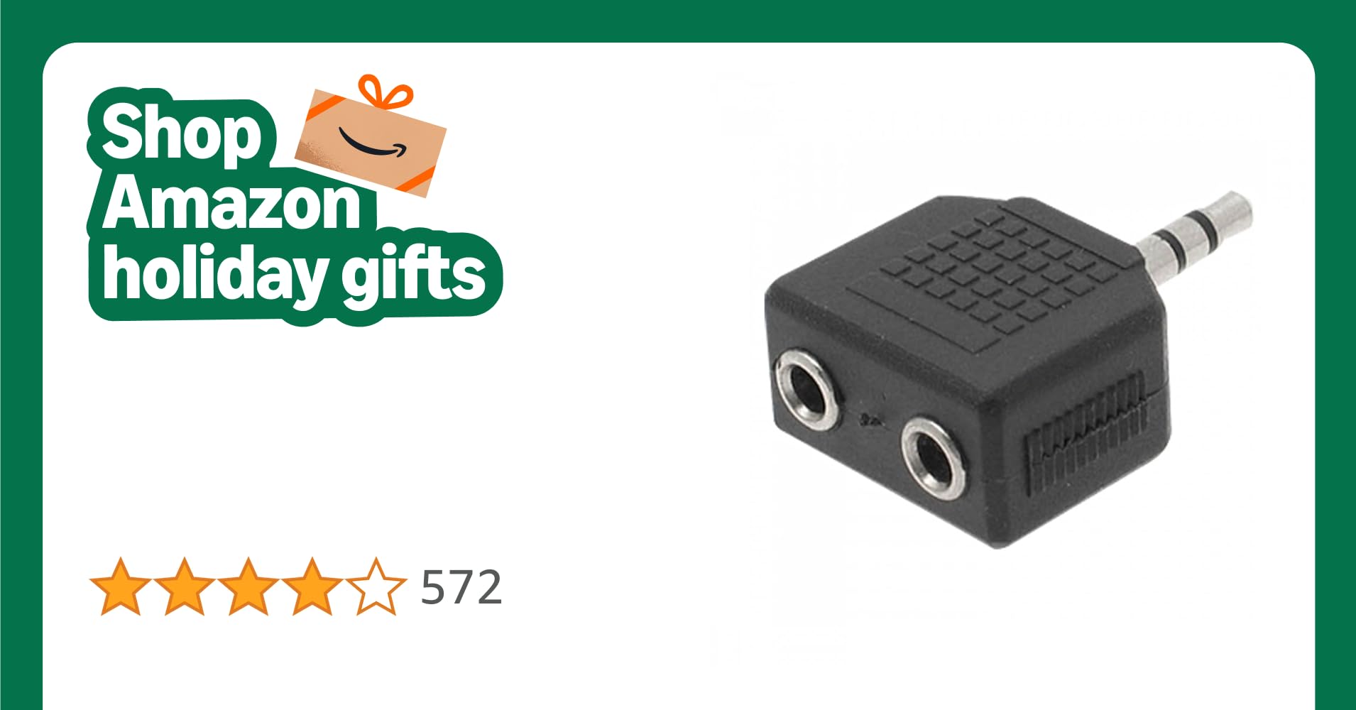

I would suggest using a minijack splitter, 3.5mm Stereo, male to two female, of which Amazon offers many, in the £1-£5 region, and hoping that the Audio Out has enough welly to drive both sets of headphones.
